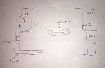

I'm in the process of finishing the basement which will be pretty well insulated. I'm looking to get a wood stove and a through the wall chimney and need some advice on sizing.
The finished part of the basement is about 1250 sq. feet. It's primarily divided into two large open sections and the stove will be by the short wall pretty much in between the areas.
My requirements are primarily on the ambience so not sure if catalytic stoves would work or not. I really like the views of Osburn 1800 and 2200 with bay windows but Lopi Rockport appeals quite a bit as well. I've read a lot about BK's on this forum and love the idea of long burn times as well as the looks of Ashford but just not sure if the ambience of the fire would fit into my requirements. Ideally of course, I would like the stove to not only serve as ambient fire source but also to heat the basement as well as act as a supplement heating to the first floor of the house. The stove will be placed literally facing the staircase to the first floor so the heat would naturally travel to the first floor when the staircase door is open.
My concern with the sizing is that my couch will be placed a couple of feet away from the stove so I'm trying to get the golden middle of not burning myself out when watching TV and heating the space up/create the ambiance. Please find attached the sketch of the basement. Forgive me in advance as I'm no artist :)
When looking at specs of the stoves, should I be staying around 1200-1300 sq. foot sizing or go up to like 1800-2000 sq. foot stoves if not more?
Thanks in advance,
Ilya

i would go with a cat stove... we sit a few feet from ours when it is cruising, and don't really have an issue. Even with a cat stove, you can still have small hot fires, or let it roll slowly.
just looked at your pictures... i would think about moving the stove location, or the tv location. You don't want to sit there and stare at the stove when you should be watching TV.

Is your L shaped couch , sectional ? If so I would put the corner at the other end . This way you can see the fire and TV. I would not want a couch that close to a hot fire. Problem with a basement install is, the floor most likely is not insulated , so you are constantly loosing heat to the floor. It will always be cold and about 4-5 ft up hot as hell . In my log home I have my Fisher Grandma Bear in the basement (about 1200 sq ft ) that has 2" of foam board insulation under the slab . When I get the floor warmed up (usually about 10 degrees less than air temp.) I cut way back on the wood use and the temp. evens out so there isn't the hot/ cold layer. A fan at the top of the stairs , blowing down to the stove , will help to move warm air up.
Reactions: ilya
I have a really big sectional placed similarly close to the stove. In fact when I mocked up the hearth extension the couch was actually over the corner of the hearth. I had a big fish tank against the wall and then the couch in front of it. I had to pull out the fish tank and slide the couch back, the fish tanks was 2' deep, so It's not like I moved the couch a lot just 2' or so. I find it fine, the sides usually don't get nearly as warm as the rest, especially on my Woodstock that has 2 layers of steel and 2 layers of soapstone along with two convective air gaps between about an inch or so. Maybe some other stoves will get much hotter on the sides.
You could rotate the couch instead of being against both walls, just have the short end against the wall at the bottom and the long end going across the room to kind block off that corner. You could then slide the stove over some and fit both stove and tv side by side that way you could watch both. Just brainstorrming, that would make it a bit more difficult to carry wood to the stove and have to go around the couch. But your proposed config does resemble mine except that my tv is on same wall as stove - above the stove above the mantle.
