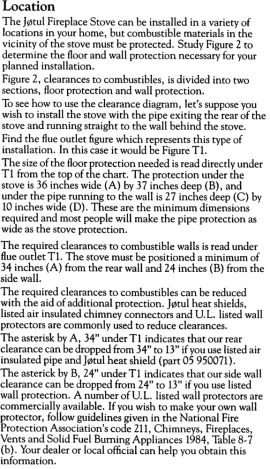

Alrighty! I feel confident I've got this figured out. We don't have a rear heat shield attached to the stove and it's single insulated pipe BUT if I'm reading this correctly the manual says it says you can use U.L listed wall protectors or make your own according to the NFPA code 211.
Hopefully I've got the numbers right. Hearth will be 36" wide by 50" deep. We will have sheet metal attached to the rear wall using one inch non combustible spacers. We will run the sheet metal behind the stove and chimney.
