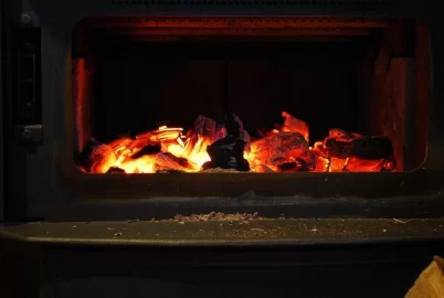

I've been waiting for this night to come to test out a cord of 2yr old White Oak. All I can say is Holy Sh*&! This has been the best burning wood I've thrown in this stove since owning it. I should say other things I've done may have influenced the burn. << I insulated the smoke shelf and damper recently.
10:00PM Sat night - Loaded stove full of White Oak. Outdoor Temp 28 Indoor temp at sitting level 70.
11:00PM Sat night - Stove air shut down to about 1/2" open. Turned blower on Auto Low
8:00AM Sun morn - Blower still blowing, Looked at rear of stove and a large coal burn. Outdoor temp 22, Indoor temp at sitting level 69.
9:00AM Sun morn - Moved coals forward and opened air
10:00AM Sun morn - Reload on large coal bed.
So, for all those with insert out there with a medium sized insert (mine is 2.3 cf), here's your answer to can an insert have an overnight burn with a good coal bed in the AM. This has been an 12 hour reload interval with a glowing coal bed.
I also feel with the White oak, I could extend the burn to 15 or more hours on a slow burn without the blower. This is a nice option if you need to load the stove and not return for several hours. The flip side to this is I could also burn it with more air acheiving a hotter burn with less time, like 8 hours.
Lesson learned - Insulate with a blockoff plate and use good hard wood and you'll achieve the results you want.
