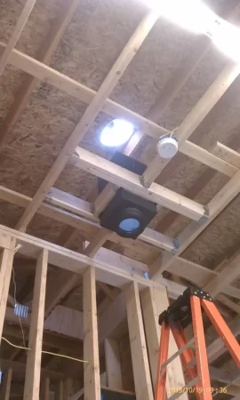

Clearances on ceiling support box

The ceiling support box is what supports the full weight of the chimney on your and both of my installs. Often, the weight of the connector pipe below to the stove is also suspended from it. It's a strong box and can support a lot of pipe IF installed per the specs. Each side of the box gets two screws into actual framing. The framing needs to be structural and solidly attached and not toenailed in junk. I chose to use simpson hangers.

The install looks fine. With a short flue like that I wouldn't worry about adding any more fasteners. Just make sure there is a 2" clearance to the wood in the attic, it's hard to tell from the pics.
I have 2 inches for sure from the pipe. I stuffed insulation all around the box though. It barely gets warm even after a long, hot burn.
You mean outside around the box right, the inside of the box should be empty except for the chimney pipe, a attic insulation shield should be clamped around the pipe covering the top of the box keeping insulation out of it.
I wouldn't worry with the shield since you have batted insulation. The box sticks up high enough to protect the pipe. Beside you'd have pull the chimney out to install the attic insulation shield.
Yes, that's fine. You need 2" clearance to the pipe.
That's why they built the box the size they did. A ceiling box for an 8" pipe would be bigger. That's one of the reasons that upsizing from a 6 to an 8 inch pipe is such a pain.
That ceiling box is also your insulation shield. It's a cool idea to get both the support and the insulation shield in one.
