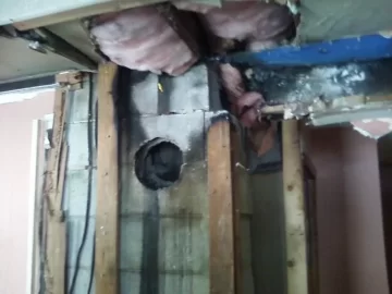

I gave an estimate to these folks today for a liner. They had a severe flue fire, everything touching the block is either charred or burned. That is a main load beam in the picture minus about two feet that burned. The nails used to attach a floor joist are still there, but the joist is gone. Happy burning everyone!
