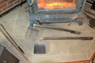

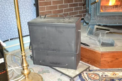

HI, I like to play with metal. So I made what I refer to as a side shovel & sifter. Before I restart the stove, I slide the ashes to the left, sift them put them to the right. than use the shovel to empty ashes. Made a can with cover, that sits on a tile stand to keep it off the rug. The bottom of the can is recessed not flat. Works for me[Hearth.com] Cleaning ashes from your stove... [Hearth.com] Cleaning ashes from your stove...
