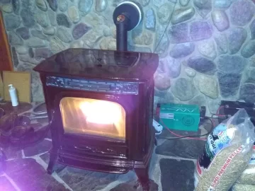

I clean my chimney once during Winter and when I take it offline. Little Ash in the pipe. Finish it up with Leaf Blower. Most of the ash is in the bottom 1/4 of chimney. I have 8" Chimney.
