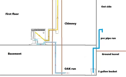

But you did give me an idea that I could possibly use the chimney to run the OAK down to the basement. Shorter run and not frigid air going into the stove.
My basement is not so sealed and some of my furnace duct dose vent heat in there but not very often when the stove is running. There is only the gas hot water heater that competes for oxygen down there and my furnace is 2 pipe direct vent ( fresh air in, exhaust out).

Well I have done a basement fresh air intake the past when I used to have a Hot blast add on wood furnace. The city inspector was surprised and impressed when I did it. I used a bucket just like this photo and it only takes oxygen when it's needed and doesn't create cold air draft and your basement to lose heat. [Hearth.com] Classic Bay 1200 smoke issue, Please help
OAK means Outside air the basement does not qualify and it can add further issues because of the chimney effect (negative pressure issues) is stronger down another level.
You have to maintain at least a 3 foot separation between the vent termination and an OAK termination (it is a forced air intake) to eliminate possibly pulling in the oxygen depleted and ash laden air from the pellet stove system.

I don't have the available 3' distance to an outside wall. Wouldn't it make sense to take air from another area of house that you can provide fresh oxygen than using the oxygen from your living space.

I also forgot to mention that the chimney was to be used as a chase for pvc piping for the oak. If I shorten it to the height to the basement ceiling than I can get the oak run less than 3 feet and it will take it from an area where fresh air is provided.

Your vent termination is high in the sky far more than the minimum three foot clearance to where your OAK termination would be. Going down is fine but the OAK termination really should not be in the basement, a ventilated crawl space is one thing a basement which has the house above it and is open to the house is an entire different kettle of fish.

PVC is a no no in a solid fuel burning system, it must be metal of a minimum thickness even.

I was thinking PVC because it is fresh air only and far clearance from any hot stove pipe, use a flex vent to terminate into the stove.

You are missing the point which is to get rid of the negative pressure in at least the burn system, placing the OAK termination in the basement puts it in a location in your house which in all likely hood has the highest negative pressure of all.
I'm looking for a air flow that goes from outside low to outside high to stop smoke from being sucked out places other than up the flue.
I have a basement install without the OAK I have a cruddy burn.

That's old school all right! Cold air won't come out of bucket unless there is a demand.
I think as long as you had metal pipe, x amount of feet from stove, you should be able to run pvc after that. I have flex metal pipe coming off my AE that is in the basement, for two feet, and then change to pvc where it goes outside thru a basement window I boarded up with styrafoam insulation between the sheets of plywood I painted.
