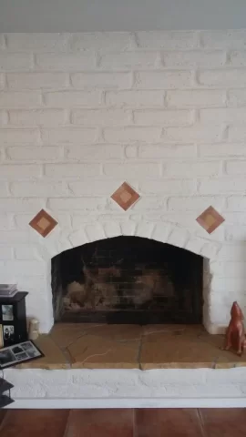

Not sure if I should start a new thread(s) as I have a couple other questions indirectly related to this thread title.
1 - Does using heated air from inside the fire box reduce stove efficiency? The wood stove draws combustible air from the bottom. It would have 10" side clearance, 6" in rear, 6" on top and 3" on the bottom. The wood stove would be elevated off the fire box bottom about 3", it would not sit flat.
2 - Their is a lot of thermal mass surrounding the chimney box and I would like to utilize it. I read that stove pipe temps, non-cat, can be well over 600 degrees closest to the wood stove.

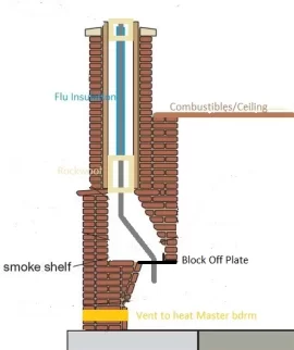

My thought is, allowing the hot pipe "above" the damper block off plate to heat up the ash shelf area. The ash shelf area could be blocked off from the upper flu with rockwool. Heating this area could heat up the chimney in the front. But more importantly, heat up the chimney/adobe wall in the rear which is where the master bedroom is. The chimney is internal and completely surrounded with adobe bricks, up to ceiling level, making a nice large thermal mass
To maintain code, does the liner insulation have to be installed within 24" (I read 24" in the code but not sure if I understood it correctly) of the combustibles? For example, if the combustible wood touching the chimney is 8' ceiling height, then insulation has to be 24" above and below that contact point?

Any other suggestions welcomed. I briefly considered knocking out the rear of the fire box and the adobe attached to it and install a vent. This could provide warm air directly to the master.
Just insulate the whole liner. You dont want to give up heat from the pipe you heat with the stove not the pipe. And yes a pipe can be 600 degrees but it shouldnt be that means you are wasting tons of heat.
With an exterior chimney most of the heat absorbed by the mass of the fireplace will be drawn outdoors. That is why the insulated block-off plate and if possible some insulation behind the stove is beneficial. Note that stuffing rockwool around the flue at the damper plate will not be as effective as that combined with a metal blockoff plate. Rockwool (Roxul) by itself will let air pass through it.
This is interiour though so i would not insulate behind the stove. I would still do a blockoff plate though
This is interior though so i would not insulate behind the stove. I would still do a blockoff plate

I agree, no reason to insulate the chimney back. Maybe some heat transfer will occur to the rear of chimney/adobe into master bedroom.
