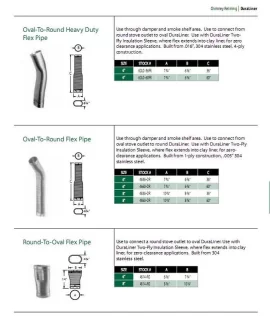

one slight problem...................the flue and the damper opening at the fireplace are 90 degrees out of sync....i would have to twist the oval to fit it through to the stove......

Well I don't know where your tee is - if it's in your smokeshelf or fireplace area (like mine), then you'd maybe be able to use one of the adapters below and use a round/round tee.
In fact, your tee is going to have to be somewhere in these two, as it's you're not fitting one in the flue..
EDIT: and as you're not fitting the tee down the chimney (check the dims in the simpson manual) , you're going to be very lucky to get it attached in your smokeshelf.
I could pull up the oval then reinsert with the adapter and pipe as I feed it down....I'm still looking to insulate the oval which extends 6 feet into the chimney.....
I'm still wondering of the JOtul would tolerate a 5in round pipe that I could insulate from the top (vermiculite etc)

I dropped my oval down into the fireplace, attached the tee, and pulled back up to the correct height. I did not insulate the flex part of the oval directly - I did buy the sleeve insulation for this part, but could not get it on due to the size of my damper opening (and this was after removal of the damper). Instead I stuffed a whole load of mineral rock wool up there and added a block off plate.
