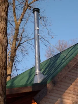

Here's the bracing on my chimney...rigid. Just so you can picture it.

Here's the bracing on my chimney...rigid. Just so you can picture it.View attachment 136354
Hey, thank you for that pic. That does help. Your stack looks fairly long like mine is. Do the rigid braces hold the chimney stable even in high winds? Not having any bracing on that top section below the cap would make me nervous. I probably do overkill with my guy wires, but the winds here can get very high and on occasion we can get straight line winds. I don't want my chimney to crash especially when I'm burning in the winter.
I have a question: Do you have any drafting problems being that close to trees? I like your storm collar - it seems to fit nice and tight. My storm collar sticks out more and sometimes I get snow blowing up under it. I would like a collar that has a steeper angle like yours. Where did you get it?
You are required to have a bracing system at every 5 ft of pipe above the roof. As noted earlier, rigid bracing for the bottom section at least would be my preference.
I paid the stove dealer to install the chimney, along with the stove. Because of the metal roof, they also brought along a couple of guys from a roofing company, to do the penetration and sealing. All of the chimney metal is Metalbestos and the roof bracing kit is Selkirk. (There are two sets of braces and I'm pretty certain the top set is within 5 feet of the chimney top).
I've been at the cabin with 55mph winds with no problem. I'm pretty certain there've been stronger winds, as it sits at the very top of a ridge. As to drafting, I've never had a problem...in fact, have started a fire easily with outside temps in the 50s

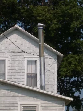

Today I installed the extra 2 feet of chimney. My stack height is now the recommended 16 ft (from top of stove to top of chimney) for my stove. I am still not 2 ft above my second story, so I left the VacuStack cap on. The lean on the chimney did not get worse. I was able to correct some of the lean with the new guy wires (including turnbuckles). I now have 10 guy wires supporting the chimney. That is a lot of stack to support, but I think it would take a tornado to blow the stack down now.

Summer, what is the distance from the stack to the second story wall?
I don't doubt that you did add the 2', but I'd enjoy seeing new pics nevertheless... ==c
Summer, what is the distance from the stack to the second story wall?I don't doubt that you did add the 2', but I'd enjoy seeing new pics nevertheless... ==c
Its 11 feet from chimney to second story wall, but probably less to second story roof because of the overhang.
Here's a pic after addition of 2 ft section of chimney.

Which way are those heavy winds coming from, across the ridge and toward the stack?
Out of the west or southwest towards the stack. Stack is on west side of house. Only time I had issues with old stove back drafting and without the additional 2 ft of chimney was high west or southwest winds above 40 mph.
With the additional chimney, you'll have better draft. I think the additional height may also get the top of the stack above the stronger portion of the downdraft. Hard to tell from the ground shot where exactly the top is in relation to the roof...and I'm no wind scientist either. ==c
