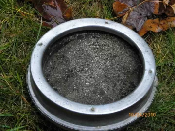

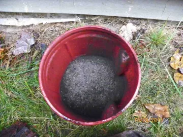

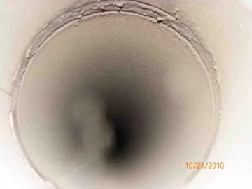

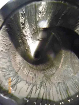

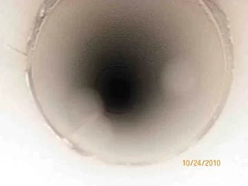

Decided that I would clean the chimney, the last time I cleaned it was at the end of Dec. 09. We have burned just over 10-11 face cord since the last cleaning if I remember right, so I'm happy with the results. The coffee can is two pounds.
Attached are some pictures of before and after.

Looks like you are doing it right. I used to go through ACS by the case with the old stove and tile chimney. I tried the new stoves and liners with and without and found no difference with dry wood so I quit buying it four years ago.

I know that this is a silly noob question, but the soot in your liner wasn't really that light grey color, was it? I'm assuming that your flash and camera meter over exposed it and made it much lighter than it really was?

Correct FixedGearFlyer, it is the same color has the dark soot in the coffee can.
