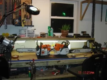

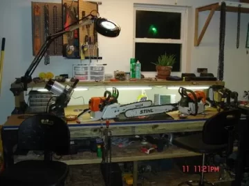

southbound said:
dishwasher............................Works really good!!!!~
I seen your pic's and had to try it wensday night when the wife wasnt home does a great job..
southbound said:
Any pic's????
I post a few sunday still cleaning them its been raining for days so I am about caught up..what the heck good enough
  • [Hearth.com] Chainsaw Maintenance/Cleaning
southbound said:
Really nice set up got there!!!!
What type of grinder you got???
I like the under the shelf lights as well........
the grinder is a old 511a with a cyclone wheel does a great job lighting is very key......built the bench with a thread on here and its working out sweet.
