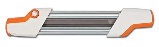

I like these. I can sharpen a chain in 10 minutes on my saw in the vise. It sharpens as good as the shops around here. It also files the rakers to the proper height at the same time. It's like a new chain when it hits the tree. They are chain (Pitch) specific.

Link? Info?
Reactions: Frank625
Here's the PFERD branded version (PFERD ChainSharp CS-X Filing Guide):
Here's what I think is the earlier model: PFERD ChainSharp Filing Guide
I say "earlier" because I saw it around before the above model.
Reactions: Frank625
I stopped at the saw shop yesterday and picked up one of the Pferd 7/32 for my 3/8" chains. Looking forward to trying it

Yeah that is basically the same. You just have to choose the right one for your chain/pitch. Same price too $40.
