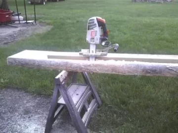

Yea the mini-mill is better. 6inch dept or less its dead on.
This pic is 4 inch deep ash was impressed with it for that job!

Is that a real saw on top of that mini mill. :vampire:

Its is......Most would not think of using one but I didnt have enough wood to use a 3/8 chain. So it sure adds weight to a tiny saw! ;-) I would take the 192t over any 50cc saw running 3/8 chain. :cheese:
Smokin what size chain does it have?
zap
.043 and 8lb saw the bar and fuel doesn't add much to the weight either. Top handle just adds to its versatility!
Lesse here, 16" 3005 mount bar (longest that will take .043), a loop of 3/8" Picco .043 chain, and saw with some more oomph than the 192.... Maybe a MS230/250? Gonna need a new clutch drum/sprocket ...... Double hmmmm.....
