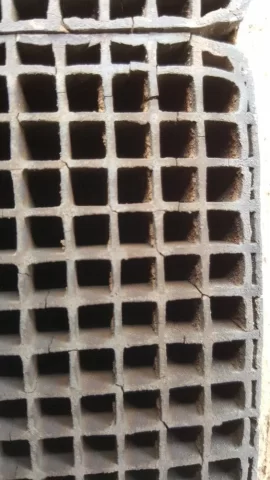

The crud brushes off easily with a soft brush.
[Hearth.com] Cat bath!
The front side of the cat has no cracks, despite some thermal abuse. The back side has lots of small cracks, but no bits falling off.

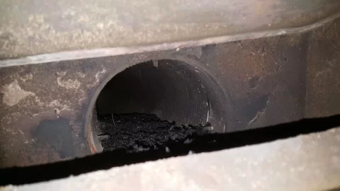

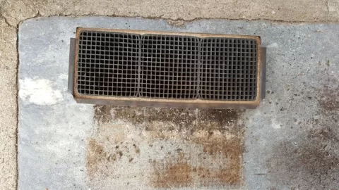

And with the cat out, I learn something new about my stove. Not only do flue sweepings land on the ledge behind the cat, they also build up in the internal angle of the flue pipe. I have to start letting the stove go cold for sweepings so I can get up in there. Look at that! 2 years of loose crud sitting there blocking a significant chunk of my airway.

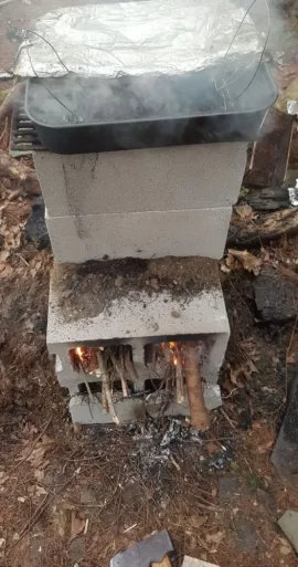

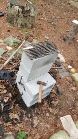

I do not have enough Wife Points to do the vinegar bath inside, and I've never used a rocket stove before, so voila... a double barrel cinder block cat boiler stove, here for one day only.

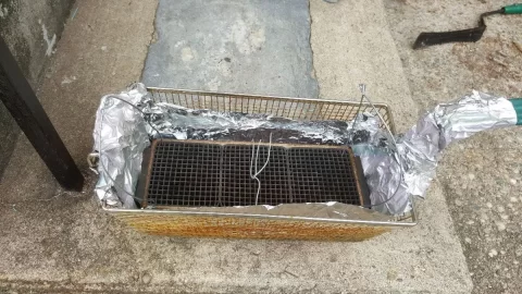

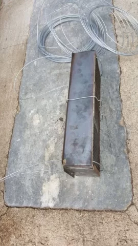

Cat grabber straps, and little feet to keep it off the bottom of the pot (you want liquid to circulate through the cells).
Disaster! I do not have a big enough pot to do this in. My big brewpot isn't wide enough, and my biggest baking pan is a bit too shallow.
A sensible man would stop here and get a suitable pot.... but not me!
Does that look like a dumb idea? Come on, give me some credit.

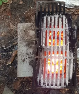

Off we go. Soon I will discover that the fry basket full of tinfoil WAS a dumb idea, and I will lose a bunch of my vinegar and water directly into the rocket stove, making me, the fire, and everyone in breathing distance distinctly unhappy.

Time for a walk while the cat cooks!
Coming out of the last bath- looks pretty clean. Water is too low because I ran out of distilled water on the last bath. You want to keep ot above the cells so water can circulate through.
That cinder block stove is still cranking. Musta fed it too many twigs.

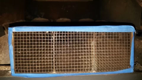

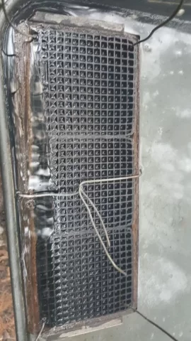

After a half dozen tries at getting the cat in without folding the new gasket over, I said 'Heck with it, I am going to tape that thing down and the tape can just burn off later'. This works well. Later I look up how you're supposed to do it, and... you're supposed to tape it. Huzzah?
That's it! I'll try to remember to come back and let y'all know how the old ceramic cat does (if it doesn't do well, I have a brand new steel one and a new gasket ready to go!)

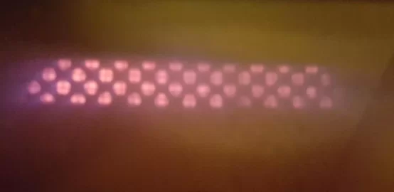

Not really stove weather yet- but the bath really woke the old cat up! I put the cat in before the probe reported active range, and it was glowing orange in about 8 seconds. Cut the air waaay back, and it just kept glowing. Looks like I will get another year out of the old ceramic cat!
(Note to new guys: your cat does not need to be glowing to be working. Go outside during the day and observe your flue. If you see and smell woodsmoke, your cat is not working. If you don't, it is.)

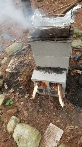

The rocket stove was temporary, but far nicer than I expected. I was impressed that I could get sustained cooking heat very quickly out of whatever twigs were nearby- all from a $6 stove. The BEST part (everyone who cooks on campfires, get ready to be impressed) was that it started out and stayed flat on top!! :)

The only thing that made me nervous was all the leaves around the base of the rocket stove. We are super dry out here. Very little rain since mid June.
I keep a rake and a shovel out there in case of mishap (that's my outdoor firepit area). I rake up all those pine needles and burn them off when it starts getting chilly out, as that's my outdoor firepit. I haul the buggy/rotten stuff out there all year when I'm splitting, and burn it in the fall and spring.

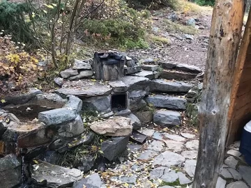

Great post jetsam like your rocket stove here is a rock stove that heats while sitting Wonderful Wyoming

fire stays lit for about 4 hours in mornings then keeps the bench warm the rest of the day. No fire while setting!
