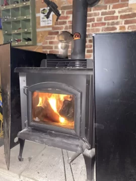

Yes, that's a J A Roby Ultimate 2015. It's a big, bargain beast, not sold in the US much if at all anymore. It's not EPA approved. We had someone install one a few years back. It's a big stove. the firebox size is a bit exaggerated which is not uncommon. Usable firebox volume is less. The mfg. appears to be including the space above the baffle in the firebox volume. Ignore the peak BTU output, more marketing that is not a practical spec for daily use.
https://www.hearth.com/talk/threads/j-a-roby-ultimate-stove-review.151049/
In milder 40º weather, like our typical shoulder season, we burn on a regular 12 hr cycle. House temps stays even, stove is about 250-300º at reload and there are plenty of coals for a restart. Do this for a couple months in fall and spring, every year. It's totally possible.
The big Drolet has about .6 cu ft more capacity than our stove. It can do 12 hrs. Of course one is going to see more like 8 hrs when it gets very cold. We have cat stove owners saying they drop down to an 8-10 hr cycle when it gets very cold too.

I'd look at the Drolet HT2000. Slightly less money, and I've seen it dip closer to $1k when Costco or TSC puts it on sale. Costco's regular price is $1599 delivered to your door and with a few accessories (fan, gloves, thermometer, moisture content reader, touch up paint, etc.). It sure seems like a lot of stove for the money and most people seem to like it. EPA certified so it's going to be presumably more efficient than the JA Roby. It's the biggest, non-cat, EPA stove available in Canada.
As I was just educated in another thread, the HT3000, which was previously recommended, would be another good alternative to the JA Roby stove. And as it's the "new' HT2000, there may be some good deals on the HT2000 come up.
