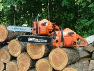

Attached is a picture of a couple Husqvarnas that I set up this way - short bar relative to the saw's power. The 238se has a 13" bar and narrow kerf chain, and the 154 has a 16" bar. These powerheads were originally equipped with 16" and 20" bars, respectively. The improvement in performance and overall saw balance have been substantial. The improvement has been most noticeable on the little 238se, which went from being a small saw that seemed barely powerful enough to take a full bar bite and was really only suitable for limbing, to a machine that is very nimble, can take a full bite of anything, and best of all, is now a truly viable firewood saw.

Match a light, powerful saw like a 346xp up with a 13-inch bar and some .325 50-gauge chain, and you can really cut some wood.
Very true, and the 346xp is an incredible saw. The only other iteam to also consider as well is balance. I just purchased a Dolmar ps5100 (4hp saw that weighs only 11 lbs and cost me $369.00).
