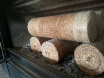

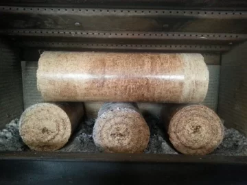

I did read the wiki. I just tried a dry fit. 3 half's NS and 2 on top EW. The back whole one rolls against the back and the front whole I fear will roll against the glass.

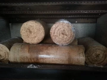

Flipped the whole and half's. This way if they roll it will be EW roll. Also, this uses 4 Niels. I could add 2 more half's, is 4.5 too much?
That will work, but it will be a bit harder starting. The front lower log will block air from hitting the base of the fire between the logs.But with 2 quarter chunks of SuperCedar I think you will be fine for starting.
Your first picture is how I loaded. I share your concern about the log rolling toward the glass so I suggest building up a little ash under the front N/S logs so that the slope is toward the back of the stove. A 1/4" of ash build up at the front of the logs should suffice.
This is an area where the HomeFire's have an advantage. They have a flat side to prevent rolling.
Yes, good point on the starting. I guess I can leave the door cracked a little for awhile, I have pretty good draft here. What's your thought on 4.5 Niels in a 1.5 cu ft stove?
Be prepared for a hot stove. These logs pack a lot of btus. If you want to be more conservative with your first fire, remove the two side halves in your E/W load. You can add them later as the fire burns down.
