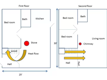

I've got a two story house that I heat wood only ( propane and heat pump backup). The floor plan on both first and second floor is open. The stove is a woodstock progress hybrid. Usually I keep the double doors to the hall closed. The first floor will stay about 75 F , the second about 65. If I get too hot I open the double doors and let the heat flow upstairs ( big orange arrows)
When the hall doors are closed , the hall way gets cool on the first floor. To mitigate that problem I have a fan located in the center that will blow hot air down, this warms it up quite a bit
The house is open plan, and the steel chimney goes straight through the living area on the second floor, which helps quite a bit
