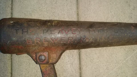

It's an old peavey, just needs a handle?

It'll need a spike for the end, too, but I don't see why you couldn't use it. The company is still in business, so maybe they could help you out.
Reactions: pen
Did you speak to the folks at http://peaveymfg.com/
Or get some wood and use some basic tools and see what you can come up with.

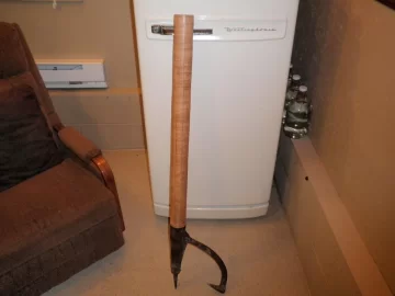

For my last one a student I know who was taking wood shop used ash and made a handle that was "close" in size for mine (he kept it big so I could finish it for a good fit). I finished just by using a draw knife to get a good fit down into the metal, some sand paper on the upper, exposed portion, and just gave it an oil finish.
One could make the handle thinner like the ones generally seen in the store, but I wanted this one beefy, and the young man made it as such!

Doesn't need to be pretty to get the job done. This one used to be owned by a buddy of mine and was lost in the woods 6 or 7 years ago. I stumbled across it and went to give it back to him (handle was almost completely rotted off, but it was rough and rotted when we were still using it years back) when he said he just found a new one of his own with his dozer while doing some work at a new piece of property he purchased that was all metal and didn't need it.
Been serving me well since, just took a little bit getting used to that thick handle, but now I really like.

I have a lathe at work and could make a handle. The biggest challenge is finding an appropriately large chunk of dry wood. I recently cut some ash blanks to ro re-handle a set of pruning loppers, but if I were to charge ahead and turn those handles now, they'd loosen up inside of a month or so.
The handle from mine was made from a couple of inch thick ash boards that were glued with biscuits, then put on the lathe.
Yeah, I could glue one up if I needed to. Guess I'm feeling a bit purist about my imaginary handleless peavey.
