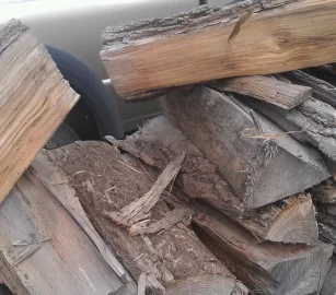

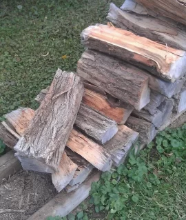

Post some pics of this BL.

Single rows with enough space between to drive a truck. Westerly winds blow through north-south rows. This stuff IS black locust, isn't it? Two years sittin' out there and the fat splits don't seem right yet. Maybe a cheapie MM in my near futurRE. Where the bark fell off is a stringy paper like skin.

So actually your assuming that the wood in you pic (that does look like BL to me) is not seasoned. Locust is still very heavy when seasoned. It looses very little of its moisture content, because it starts out with little to begin with.
Get yourself a MM. You'll be pleasantly surprised by Mr. Locust. I have some super dry locust that rings like a bell when hit together. These have been seasoned for a few years.
