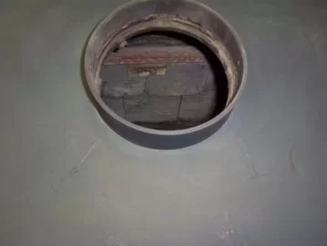

I experienced a rather freakish occurrence last Sunday. While loading up my 10 yo Osburn 2400 I noticed 2 cracks had developed in the cook top, emanating from the smoke pipe hole outwards, towards the center. One crack was 4" long, the other 2.5". They hadn't opened up very much, but they were visible. Of course, I became very concerned and immediately began a search to find another stove. As you can see in my sig, I am now a proud owner of a Summit, and boy, what a stove it is. More on that in a bit.
The cracks in the 2400 appear to have started exactly where the fire stop plate is welded to the bottom side of the cook top. I cannot confirm this, as I haven't yet taken the baffle apart to really have a good look. I will get at it this weekend. I always burned the stove as the book stated, allowing the secondary burn to start and throttle the stove back to anywhere between 25-50%.... depending on the temp outside. The stove was never over fired. I have always burned seasoned (I am always 2 years ahead with my wood) hardwood, consisting of maple, oak, ash and white and yellow birch. All of my wood is spilt and piled for 1 year on pallets and then moved into the wood house for the upcoming season. I built an 8X16 shed roof style wood house, which I can store about 6-6.5 cords of wood in, so there is never an issue with my wood not being seasoned.
What I would like to know is, has anyone ever had this happen to their Osburn before? If so, may I ask what was done with respect to warranty and such? I am currently corresponding with the warranty people at Osburn and they are very concerned about covering their own backside with my stove...meaning they are desperately trying to disprove my claim. I am fully aware of Osburn warranty; in that they do not cover the plate material the stove is constructed from. I am concerned though that this could be a defect which they may/should be wary over. Imagine a stove owner not as lucky as I to notice the cracks. I do not want to think of what would have happened it those cracks split and opened up and 3 am when my family was turned in.

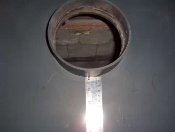

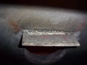

Just today was I able to find the time to take pictures of the cracks, which I emailed to the warranty person at Osburn. You are right about the location of the cracks Roo; both started where the welds of the fire stop plate ended. Very scary. I tried to take a picture to show the deflection that occurred in the area between the cracks but my digi cam does not have the pixels to show that detail. I estimate 2-3 thou variance between the area of the cracks, which is about 6-9 inches. Hopefully the following pictures will demonstrate.
As you can see in the pictures, the cracks are very prevalent. The fire stop plate is not warped, actually, I was amazed the shape it is in. The bottom side of the cook top in not charred, which would indicate abuse, such as over firing. It seems that it is definitely a design flaw and a shame that a good old stove, with many years left in it, is destined for a plasma cutter (unless Osburn will buy it back from me!?!).
Any comments, pointers or guidance will be graciously accepted. I will keep all updated whether Osburn accepts responsibility and accountability of this.

First problem with the Osburn crack issue is that this piece was welded where and how it was. As we know steel when heated expands and contracts , just no two ways about it , with this piece welded where it is its just bound to happen and looks like a design flaw to me , when the steel expands and contracts the welded piece is not going to let this part of the steel plate move as it should and in turn the steel plate cracks.
The only way i could see fixing this issue is to have the steel piece cut out and smoothed , take the cracks and V groove them out with a drill hole at the end of the crack to stop and further cracking. Plug weld the drill hole at the end of the crack and then weld up the V groove were the cracks are. To replace the heat shield it actually needs a better design but a couple small steel bolts could be welded to the bottom of the plate and some ring holders welded to the steel piece and bolt the steel piece in , what happens now it it lets the steel piece float as the body of the steel stove expand and contract.
