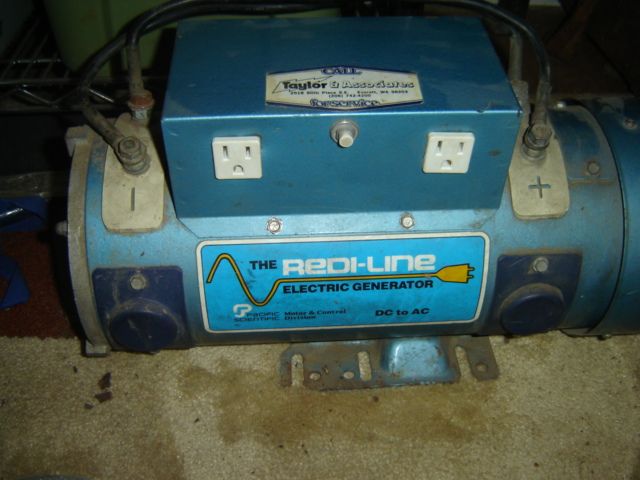

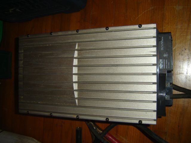

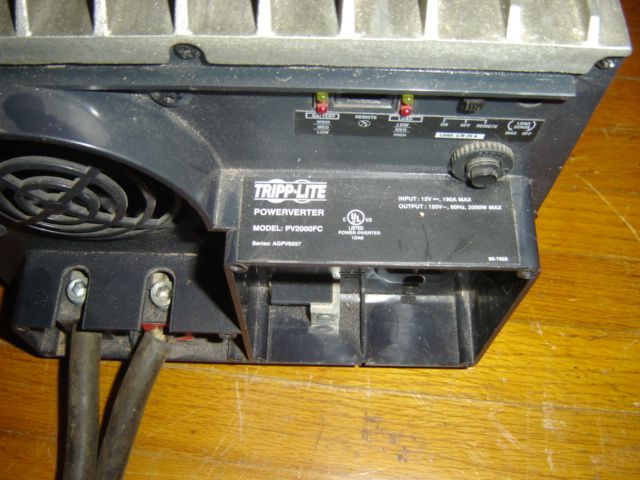

I'm using two sine wave inverters .. Trip Lite PV2000FC 2000 watt continuous, 3000 watt one hour, 4000 watt peak .. Maintains PWM sine wave output voltage of 120 V AC (+/-5%) Ideal for industrial power tools, window air conditioners, electric motors, pumps, desktop computers, laptops, portable electronics, etc.
other inverter is a Redi-Line which is really a rotating AC generator that puts out true sine wave .. it's got 1600 watt output ..
