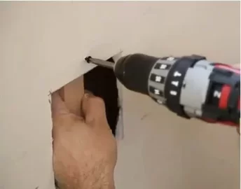

Best way to patch that big round hole in the drywall near the top left is to screw a piece of strapping in the hole as shown. Then screw the round piece of plaster that was cut out to the strapping.
Click pic to enlarge
