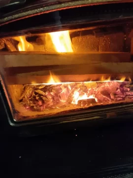

If I just throw them in as is then it hisses and I get a lot of white smoke coming out the flue. When I look at a piece that's been in there you can see the sizzling water on the sides.A photo of the cap would be great. Also the wood that is green is water coming out the ends when burning?

Thanks. I don't think I'm in any immediate danger. As simpleas it all is this is also a nice learning process on what I'm doing.So it's about 100 hours, i.e. 5 full time days.
I'm not sure how fast things can go bad, but this is a short time. Regardless, it's good it doesn't look bad at this time (if no glaze in there that you couldn't get off). Good to keep an eye on the cap indeed.
I know for a fact the cap is blackened. No Shiney glaze and no clumps of creasote when I was up there in October.
If I can I will. Right now we are going through a bit of a storm but if things become safe throughout the month I'll get this data for you.Yes, then. But if this was my system, I'd like to know how it's now. Because even if the data you have now are (indeed) not very concerning, problems can happen up there.
Not sure you can get up there though this time of the year.
Did you check the chimney for creosote glaze? Just because nothing came out doesn't mean there is nothing there.I should have elaborate more. It's literally those black flex on the ash. Nothing else came down. Maby 2 tablespoons worth.
It's become an increasingly occupied day. I did not run a fire 🔥 today. But I will post up a picture from the bottom up with a flashlight before I run my next fire. Unfortunately weather does not permit going on the roof 😕. But I will follow up with that asap.Did you check the chimney for creosote glaze? Just because nothing came out doesn't mean there is nothing there.
The bottom won't tell you much unless the creosote problem is really badIt's become an increasingly occupied day. I did not run a fire 🔥 today. But I will post up a picture from the bottom up with a flashlight before I run my next fire.

Thanks. I can confirm there was no creasote after my brush in October. I will take pictures next time mainly because burning green has raised some questions for me that I would like to know more about. In light of this I will post up pictures as soon as I can safely get on my roof.The bottom won't tell you much unless the creosote problem is really bad
