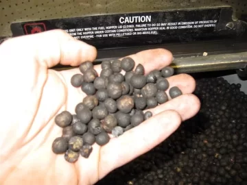

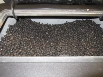

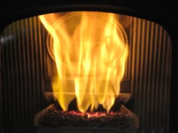

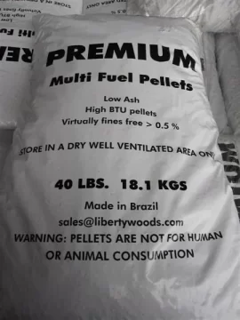

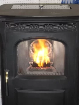

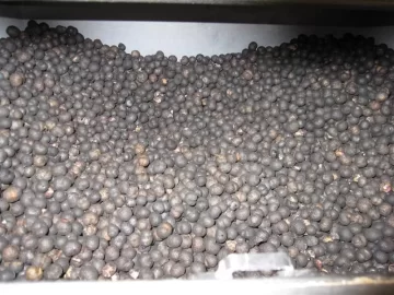

here's something new Im trying....Acai pits......
7800-8300 BTU's/lb
less than .8% ash
Early observations:
little to NO fines in the bag
much less susceptible to water than wood pellets
the pits are smoky smelling....kinda like jerky
slightly harder to light, but the Accentra shown did light them off on the second cycle
ash similar to pellet ash, maybe a bit grittier
price: would be roughly the same as wood pellets, judging by landed cost
