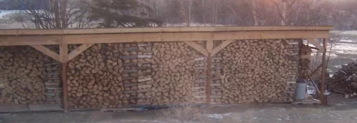

I chose the open type with no walls. I put it where it worked best for my property & with my wife's input for location of course.
I saw many on here that used it a property line divider. We liked that & was the best use of space for us.
Mine is 4 row deep, which may not get good air circulation t the middle rows but with my winter winds, I'm sure it's circulating
Many say to season the wood in individual rows, out in the open, then put it in the shed when seasoned, it seasons faster that way for sure.
I didn't have that option & wanted a shed to keep it off the ground, get as good of air movement as I could,
I put it along property line. It fits into the property well & I can find it in the snow, pretty good air circulation
Some have enclosed on 3 sides, some 2, some 1, some use chain link sides. Lots of options.
Open sides gives the best possible air circulation.

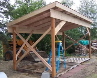

Ultimate: Wind direction on the front or back for air, North south so both sides get good sun. Big enough to
have about 1' of space between rows & off the ground on pallets or spaced floor boards for bottom air & dry the
wood before it goes into a multi row enclosed one, easy access, fits well on the property
& #1: "approved by spouse". (Now figure out where, how many cords you want to store. design the shape & size)
It comes down to what you like & works best for you.
My basic was: any is better than none, affordable, air, off the ground, handle the wind,hold 2+ yrs supply & we like it.
I got a "hybrid" one, I meet some of the "ultimate" & it works great for us.

My woodshed had no walls but in the first winter I would get a lot of snow blowing into the wood on the windward side (west). I put in a temporary tarp on that end 15 years ago and its still there. I have a hanging tarp over the front of the shed (south side) that I use in the winter to keep snow out. The back of the shelter is open and butts up against some softwoods, the east end is open year round. I get a lot more snow in northern NH than CT. The other thing to consider is structural bracing. Ideally you want at least 2 walls at 90 degree angles that have either a solid wall or an X brace. This really stiffens the structure up and makea a big difference if you get heavy snow. If you brace the structure, you can get away with a lot less extensive foundation for the posts. Mine are just PT poles set in holes in the ground with no concrete.
Your pic on the left is the first time I've noticed the skid steer hiding in the trees. Here I thought you lugged all that wood around by hand.
I didn't use the skid-steer to move the wood, that's my neighbor's, we leveled the ground, removed some old stumps & roots
& spread some sand down for drainage under the pallets . (I have great neighbors)
Wood not lugged by hand though, I used my ATV/trailer & wheel barrow to move the wood.
The skid-steer sinks in & leaves ruts, & you know when you turn them on grass how they rip it up.
