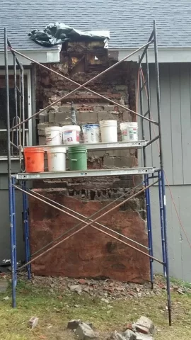

That's the problem, I've had 2 Masons look at it so far. I don't know who to believe that's why I'm asking to try and get a little background information. I'll find a picture of the inside.
The inside also has some white on some of the mortar.

It's good to get a second or third opinion. What was the opinion of the masons that have looked at this?
Maybe find a mason that has restored historic fireplaces and chimneys. You’re doing essentially a restoration of what you can salvage. In some cases restoring can be just as expensive as starting over because of the effort to save what is there. If the block wall in the basement is good, which it should be if the mortar is hard then that seems like the only portion worth leaving in place. Only an expert mason’s inspection can give you a final answer. Have you talked to a carpenter? They have to rebuild your wood framed wall and to do that with the old chimney in place may be difficult. Also you have jack studs up against the chimney that form the rough opening, are they rotted? They can’t be easily replaced with the chimney in place and all of the new construction has to prevent future water infiltration, much easier to accomplish by starting over.
The one that will install propane insert forwarded me to masons, he seems to think it can be done. The one that tore the chimney down said it would be less expensive to enclose what is there with exterior walls and use a vent free unit. He's too busy to come back, just left me the way it is. He said the back can't come down without having the inside come down.

Yes you can transition from masonry to metal chimney. But what you have would still need to be rebuilt. From the pics it looks like it is in pretty bad shape. If you were going to transition to metal you would build the firebox and smoke chamber then transition from there. going that direction the labor would be less but the materials will be more. It is worth pricing it out.
