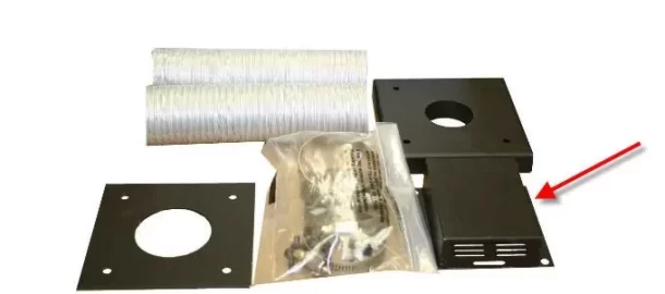

I had an Englander PU-OAK that was missing the clamps and bug screen and outside weather hood.
See ESW OAK manual here > http://www.englanderstoves.com/manuals/PU-OAK_Info.pdf
I know auto parts stores have radiator clamps so that was easy. One for 2 inch hose works fine.

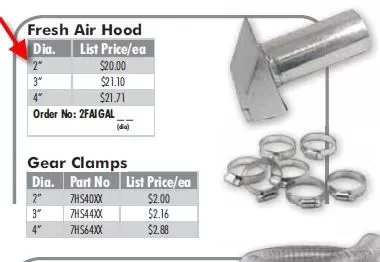

I called England Stove Works and they do not sell the parts separate except $30.00 for the 2" aluminum flex pipe. A new kit is $60.58 ! !

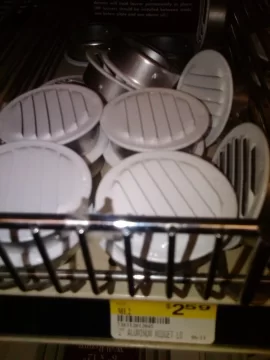

So I went to the hardware store and found some round 2" inch soffit vents with a bug screen for $2.59

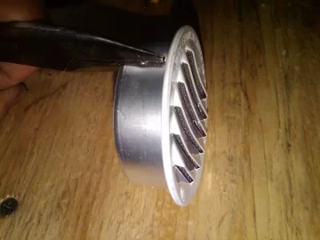

Took it home and with some long nose plyers I pushed the nipple in that holds it into the wooden soffit.

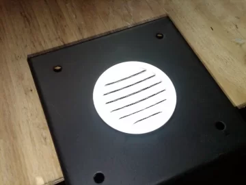

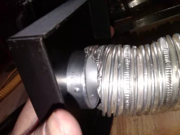

Then pushed it into the OAK outside flange. It fits perfect, then using high temp RTV, I can seal it in.
Then clamp on hose and Bingo it works!
The outside weather hood is not really needed with this soffit vent that has louvers on it.
