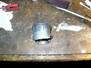

If you are willing to spend the time you can often save the cylinder, using muratic acid and fine sandpaper you can remove aluminum transfer. If the cylinder is really bad has deep scratches, or you are in hurry you may need to replace it.
I was able to save both cylinders on my Husky 350 and 36.
You can see the pic of the piston of the 350 is pretty bad.
Check Ebay and http://www.jackssmallengines.com/ for replacement prts.
see chainsaw forum http://www.arboristsite.com/
When you order the parts get a set of crank seals.

With a new OEM cylinder being only $35, I wouldn't bother trying to clean it up... JMHO...
I hope you can fix it. Two saws will be nice.
Looks like strait gas to me... Or a really really bad air leak....
For the price of the sand paper and acid and your time I would just pick up the piston and cylinder...
