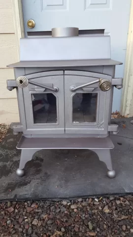

Hello, new to the site.
Looking to find some information on this stove i recently purchased. Appears to be a Brown honey bear with glass doors and gold ball feet. Serial number is 293 and that's all I can read off the plate. Wondering if it is ul listed and maybe year manufactured.
Thanks

Wow, that's an early one. '80 or '81? Never saw one with Fireplace Legs.
If you open the right door, there may be a number stamped into the stove face above door opening where the arched door top covers it when closed. The early Honey Bear Inserts built like yours had it stamped there. Maybe that was before tags?

If something like that came up for sale around me, it would be a keeper. That is a good example of one of the first Honey Bears. The Smoke Shelf Baffle must have been used in the first ones before they went to a round flat plate that hangs across the outlet. Your baffle is the design in Goldilocks and Teddy Bear, but both of them were 5/16 thick and didn't warp. Maybe they learned from your model. Are the legs bolted on or welded? They were soon only made in the pedestal or convertible mobile home certified version.
When you clean the existing glass you may find it is amber in color, not clear. That isn't from smoke, they had a gold tint. I believe CanFan on this Forum still has some Honey Bear glass panels that should match the brown tinted color.
In my house, 4 brown ones may be the limit. ;lol A few existed before we were married, so she knew what she was getting into.
The legs are welded on.
