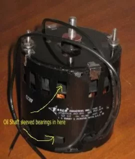

You need to oil the motor bushings. Not the shaft on the blower wheel. Look inside the motor. At each end there is a sleeve next to the motor case end. Oil the sleeved bushings inside it!
Also WD-40 doesn't last that long maybe a couple of weeks. But you can see if it will quit down for now!
I use 3 in 1 or 10 weight oil.
Let me see if I can get a photo of where you need to oil it!
jay

Once the bearings start to make noise it is only time before the noise will be loud enough that you can not stand the noise. I would look for a convection blower, $165.00 plus shipping.
