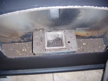

Anyone have of pic of what this looks like?
Attached is a pic of my burn pot
