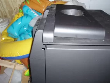

Does anyone have a convection deck on their Princess? I picked one up today and I don't think it's made right, I think the fins are welded into the wrong side of the deck. Can anyone take some close up pictures of theirs or measurement the distance on either side of the flue opening from front to back?

This is what I'm dealing with, I'm not sure if I'm missing something or not. The blowers were already installed so I guess they could be wrong although they look right. It looks to me like it needs to be flipped but then the fins are on the inside.
The only other thought I have is the piece of the blower along the top needs to move back some to allow for the convection deck to move back enough to fit. I haven't looked at how that's installed close enough yet.

It looks like the blowers were the standard blower kit. I think the sheet metal on the top of the blowers is different on the Ultra. It doesn't extend onto the top deck at all.

The princess has rails that mount into the rear piece of the blower so I'm not sure if they can be much different. The Kings deck appears to be different from the pictures I've looked at. I'm thinking the top piece may need to move back, the part number on the stove is for an Ultra? Hmmmm
cmonSTART what does the blower on yours look like from the side shot?
Your blowers appear correct.
I do think your fins are on the wrong side. They should be on the side which measures approx. 1.25" from the hole to the side edge. Doh.
Edit: Turn the deck around. Does it fit that way?

Yep seems to fit perfect that way, I tried that when I first started looking at it and thought " that can't be right the fins should be on the outside" My fins are on the side that is 3/4"! Typical... :lol: I'm hoping to install the stove tomorrow, at least it won't hold up me burning the stove if I need to.
Thanks a bunch for the help!!
