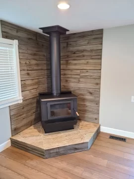

Thank you. After you build a solid foundation, get stone tile laid, then paint horizontal darker stripes (so as to not see wall between planks), you place construction adhesive on the back of each piece. You measure out wall stud locations, predrilled 1/8" pilot holes for screws, you start hanging the MagraHearth boards.Super clean install BKVP, but we would expect nothing less from you. That cement wall material just looks fantastic.
MagraHearth did a complete schematic so my total "waste" was less than 7" of cut material. Came with field kit with cement filler (cover screw holes) and stain for these patches and cut ends....
Then drop a stove!
