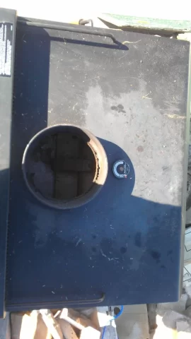

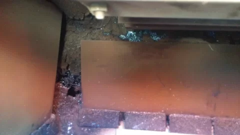

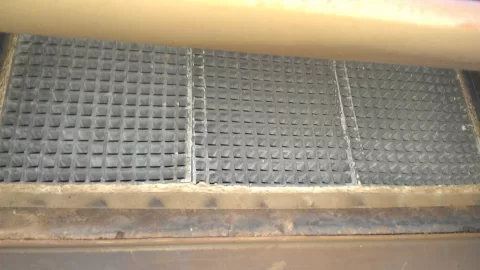

I just picked a blaze king classic off craigslist for 1200. I don't have any experience with cat stoves. it's a 2010 model . The stove has a bunch of creosote build up inside that needs to be cleaned. I was wondering if anyone can tell from the pic if the cat needs to be replaced Blaze king classic Blaze king classic Blaze king classic
Reactions: raybonz
Congratulations. That sounds like a great deal if the stove is in nice condition. Visually the cat appears to be in good shape. I wouldn't bother cleaning off the sote in the firebox. Just burn it out with a hot fire or two.
Thanks for the info. I was thinking about trying to burn it off but there is a lot in there.
Just to be sure, did you take the flame guard off that mounts in front of the cat? It looks like a nice find! Hit it with a can of Satin Stove Bright and it will look new again!

The cat and gasket look remarkably good. Dollar bill the door gasket, take a look at the bypass gasket and make sure it closes relatively firmly, and burn away.
Oh, and check the glass gasket by palming each side of the glass and making sure there is no movement.

it passes the dollar bill test but I don't see a gasket aroundthe bypass
