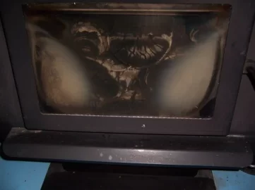

Mine gets black glass on burns below 2, & clean (but stains where it was black) above 2.25. (but this varies by weather, "high pressure/low pressure" & wind)
Like mentioned, the drier the wood, the cleaner, but on low burns, regardless of the wood, my glass is dark on the sides.
Pic is what I call "Fire dragon eyes" When black; burning cool long burns, closed eyes & taking a nap
when lighter colored; hotter burn eyes open, lighter yet, wide awake & stay a foot away or get cooked
The middle area stays pretty clean most all the time.

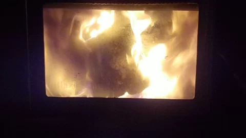

Pic is a 2.5 burn, hot & awake, but can go hotter if needed.
