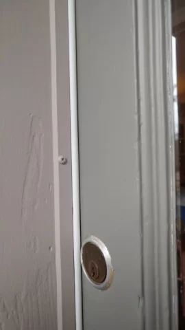

Another cheap, easy fix. There may be other door weatherstripping that works well, but I found this to be effective. With the door closed, you lightly touch the bulb to the door, then screw it to the jamb. If you push the bulb against the door too hard, it will keep the door from closing. But the screw holes are oval, so you can adjust it if needed.

I just removed a whole bunch of those because the flexible part became inflexible in short order.
These have been up maybe five years. Like I said, you can't press them too hard against the door when you install them, just barely touching is what you want. They might be a little stiffer, I can't tell, but I don't feel any cold air coming through yet. They weren't real flexy to begin with, as I recall. I should go around the door with a flashlight at night and check how they are sealing. They are M-D brand that I got at Home Despot.
What was the problem caused by the ones that were stiff, that you removed? Door hard to close? Air leaking?
I have never had good luck with that type at all either.

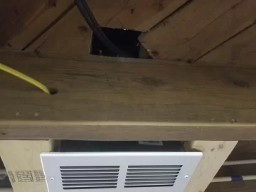

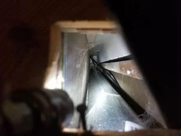

I found the one answer to this late last winter. I had a hole in the basement ceiling that extended into the attic through a wall. It was 4 ft in front of the stove was like a warm chimney into the attic.
