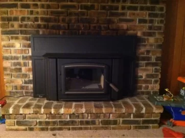

The Lopi 1750i extends a little onto the hearth but not excessive, for clearance you can get a removable stove board for ember protection in front. I've been pretty thrilled with ours, you can actually cook on it and while we use the blower most of the time it would convect nicely with an outage.

Just wanted to follow up. We purchased the Neo 2.5, but it did not fit in our fireplace! The specs from the manufacturer are incorrect! We ended up buying the Regency CI2600. It is more expensive than the Neo 2.5 but has a larger viewing window. I will start a new thread on the Regency.
