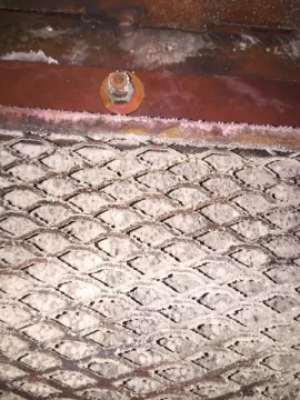

The razor was the only thing that would get off the thick black build ups. I thought my wood was wet but my catalyst was clogged up with ash.
[Hearth.com] Best method for cleaning glass?
Cleaned it out and fire burns MUCH hotter. I'm getting all night burns with the air turn off and much cleaner glass. Still a bit of residue around the edges. I can live with that. I will clean it off with the suggested methods when removing ash once a week. These forums have preached the benefits of dry wood and I'm a confirmed believer. Thanks!
