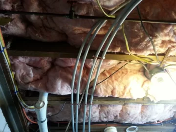

Okay, this worries me cause the quote I got also include the area where the stairs come down to the garage from the kitchen. Quote calls for the ceiling to get completely foamed and interior walls insulated. This area is affected more by the colder garage air and outside walls where the stairs come down. This area is about 8x20. I am attaching some pic as a visual.

This area in the pics is not living space, its only a walk-through area. It will never be heated from below. Its closed off from the larger area of the basement by two 2" insulated doors. The issue is that this walk-through area is directly under the kitchen in the part of the common area furthest from the inserts. The heat eventually gets there, but as you can imagine the sink/counter/stove area is the area first used in the mornings.
You may ask them the advantages of doing the ceiling if your doing the walls. The company may have simply saw you had insulation on the ceiling and gave you a quote for replacing it. You may be reading into it to much.

I read somewhere that the rule if thumb for spray foam on ceiling was if the space below it was conditioned or not. well the space below my kitchen is not and is also sealed from any space that is conditioned, as in the rest of the basement. I think spray foam is a good solution. especially since the stairs are resting hard against the wall. that would be a challenge to insulate with foam board.
Here is my rule of thumb for insulation. If the basement or crawlspace is completely unconditioned space then it would find to make the ceiling your insulation plane and insulate AND air seal it. But that means absolutely no heat in the basement at all. No pipes. Not heating equipment, nada. If its truly a COLD space then absolutely insulate it out of the house and you have that much less space to heat.
