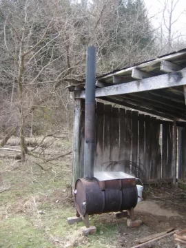

THose are actually bungs!!! You cut out an old barrel (imagine all of the nice old chemical barrels converted to this) and install the iron door and flanges/legs. The top barrel is an optional "heat chamber" that's supposed to increase your heat output. I got one at an auction for $5 (only the bottom barrel) and cut the top out to fit with stainless chafing pans - fill pans with maple sap, build a fire, and cram pallet wood that I got from behind tractor supply in all day while I down a case of fine beer. It's outside, so no chance of buring anyhting down. I actually TRY to get the thing glowing red. I have had a 30' column of flame coming out the 10' chimney. It lets you do everyhting you're not supposed to do with your wood stove. i woudl definitley be aprehensive about putting one someplace you don't want to burn down...

Here's the best thing to do with a barrel stove:
Great for making maple syrup!
