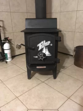

I have an old set of Malco brand hand crimpers. A senior journeyman tin banger gave them to me when I was an apprentice. Over the years fellow sheetmetal guys and I have always compared the different sets and mine have always seemed to crimp the best. I used to have to chase them down because someone had always 'borrowed' them.;) That being said and even though I have crimped hundreds if not thousands of pieces of pipe, I could not crimp a 6" elbow to fit the back of my baby bear. I ended up doing what coaly did and used a 6" T. I could have probably went back to one of the shops that I worked in and manufactured a tapered 53/4" to 6" 90 degree elbow, but couldn't bother. I did think of going to the shop and using their power crimper though. They are adjustable depthwise so you could start the crimp in much further than with hand crimpers. Any HVAC shop would have them and it would take less than a minute to run one through. But, I like the idea of the T for clean out purposes.

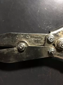

Do they look like these?
[Hearth.com] Baby Bear Pipe [Hearth.com] Baby Bear Pipe
That C1 is 9 1/2 long. Mine is the C5 at 10 1/2. Heavier duty version that says pipe crimper on it;

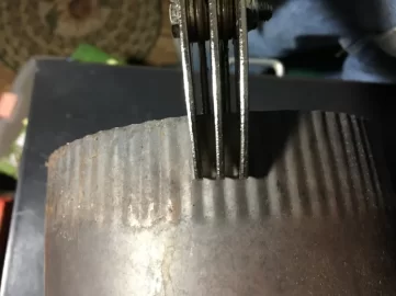

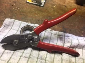

I tuned mine up today to match the factory flutes exact. Very simple too.
I removed the pivot bolt under the word Malco that the two jaws pivot on. There are 4 spacers, one each between each jaw. They are about twice as thick as a regular washer. I chose the thinnest 1/4 inch washers I had to put between each blade. So you can adjust the space between the blades easily. Here is the adjustment to match factory crimp;
