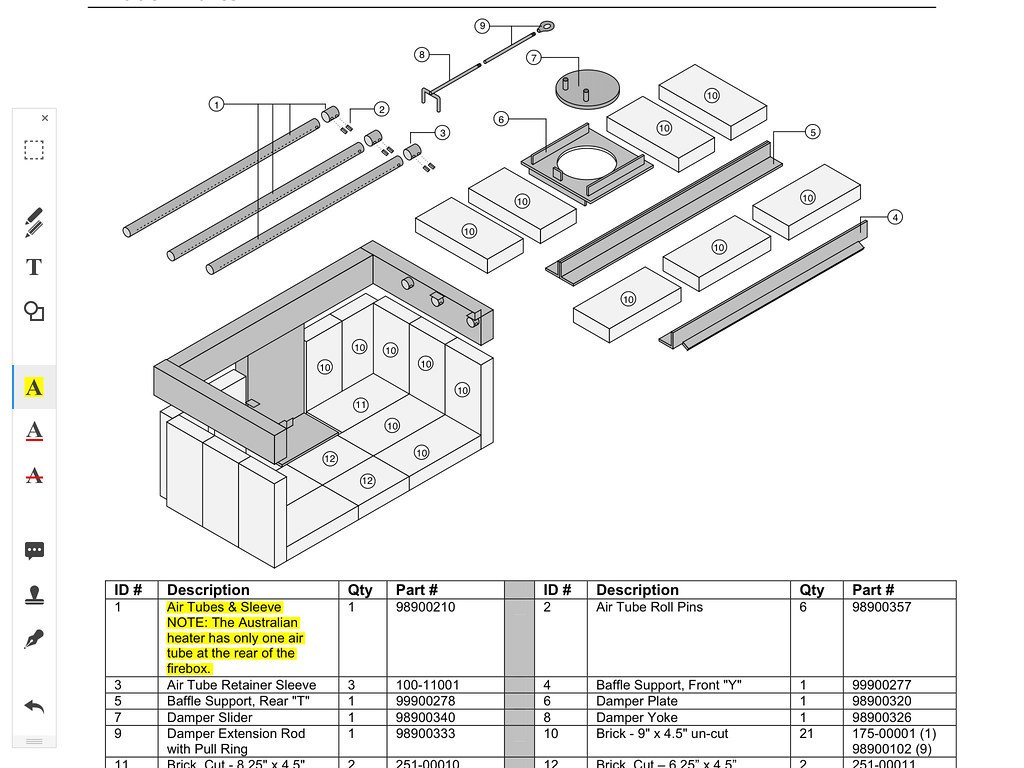

Here is a scree grab from the user manual in Australia. I have highlighted the relevant section. I have also inspected the liberty at the dealers and it has one tube.

That's an odd one. Is the manifold set up for 3 tubes with plugs in the holes for two sets?

That is a monster reburn tube with monster holes in it.
Sure don't understand it but you are definitely right. Even the ad brochure just shows one tube.
