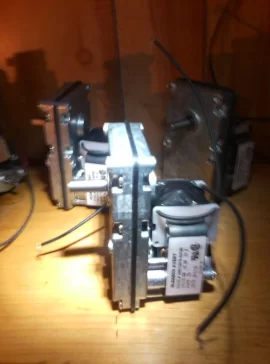

Just got some 1 & 2 RPM GAs in and I must say they are strong and handsome. Look at those shinny screws and nice gasketing!
