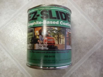

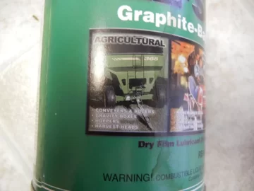

I have great success with this graphite product [Hearth.com] auger lubricating [Hearth.com] auger lubricating
Have not pulled the auger on them yet. No need to make work if one does not need to. Hestia and Kernal burner boiler though.
