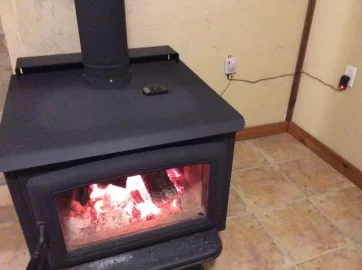

So I've been considering getting another auberin unit for my insert. I'm not happy with my lack of monitoring ability. The stovetop of the insert seems like the logical thing to monitor but I'm unsure of my best bet. My ring thermocouple still seems deadly accurate and fast acting on my single wall stovepipe on my summit freestander and the reports in this thread of the magnetic one not working well have me wondering what the best thermocouple and way to mount it would be?
My insert chimney is fully insulated and I'm not looking to rip down my block off plate and roxul to try and mount a thermocouple aways up to monitor flue temps twelve to eighteen inches away. I'd be happy with a accurate stovetop reading.
I may end up ordering a probe thermocouple. I'd like to switch my summit freestander over to double wall connecting pipe, so I'd use the probe on it. Then I'd just have to figure the best way and place to mount the ring thermocouple to the insert?
