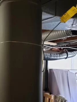

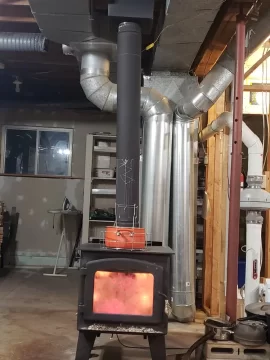

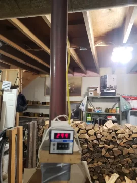

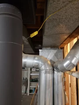

I've been running my Drolet Austral I for the last 9 years strictly by using flu temps. I use a K type thermocouple wired to a digital readout to measure the double-wall flu temps at 40" above the stove top, so that the thermocouple wire is clear of the stove top and strung neatly along the ceiling to the readout by my couch in the basement. Stove is vented straight up & out 22', with a key damper right above the stove top. I always aim to run it at my ideal temp of 315°C (599°F), although I'll often allow it to reach ~345°C (653°F) if I'm in need of pushing it; however I've hardly needed to push it at all last winter, and certainly not much again this winter.... 🙄

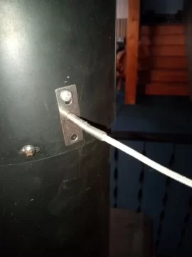

There is a bracket attached to the thermocouple that screws to the pipe. Unscrew it, slide it out, clean, put it back in.[Hearth.com] Auber and probe thermometer users
