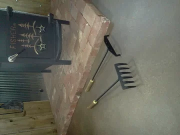

Was setting out in the shed tending the Mama Bear. Normally I read when doing this, however I couldn't concentrate today. So I decided to build stuff. This is what I ended up with. The rake was made out of a old garden rake and 1/4" pipe. The leveler was a piece of 1/8" steel that I milled the center out of so it would leave 1"of ash on the brick.
Just cut the wooden handle off of the old rake to put on the 1/4" pipe.![Ash Rake/Ash Leveler Ash Rake/Ash Leveler](https://www.hearth.com/talk/data/attachments/120/120600-1a6e3d95b888b8233690c147bd862144.jpg)
